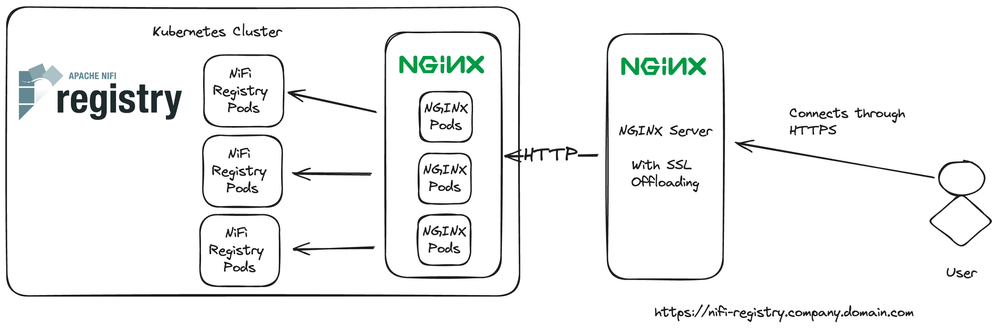

We are working on deploying the NiFi Registry platform on kubernetes, however, we are hitting some issues. I've added a diagram of our deployment to help give some context as well.
Test Case 1: When proxying NiFi registry with settings as unsecure, the proxying works fine. We are able to connect to https://nifi-registry.company.domain.com and view the registry as needed. Note the HTTPS in the URL still - we are using SSL offloading in our nginx's.
Test Case 2: When proxying NiFi registry with settings as secure, we get ERR_TOO_MANY_REDIRECTS. I have attached our nifi-registry.properties file as well. One thing that we found interesting, was that when we tried the below curl request from within the pod we get back a normal response
curl -k --cacert /opt/nifi-registry/nifi-registry-current/tls/cert-manager/ca.crt --key /opt/nifi-registry/nifi-registry-current/tls/cert-manager/tls.key --cert /opt/nifi-registry/nifi-registry-current/tls/cert-manager/tls.crt https://localhost:18443/nifi-registry -vvvvvv -sS -D -
The certs are valid as they are generated by cert manager. We are looking for any assistance that you can give, but some of our main questions are as follows:
  • In our kubernetes ingress details, should we set the path to just `/` or `/nifi-registry`?
  • Is it possible that the NiFi registry is redirecting the client from the HTTPS endpoint a normal HTTP endpoint? We see in the browser network tab that it seems to flip back and forth.
  • Is it 100% required to have the authorizers.xml completed in order to get this working?
  • Any other ideas of what could be causing this?

I can answer your first question, the path at the ingress needs to be "/".
If you share more information about your setup (like the yaml files used for deploying), I might be able to help you more.

To use the certificates stored in the NiFi-Registry you would need to set the ingress to SSL-Passthrough, which means removing the annotiation "nginx.ingress.kubernetes.io/backend-protocol: HTTPS" and replacing it with "
nginx.ingress.kubernetes.io/ssl-passthrough: "true""
Also this feature needs to be enabled at the ingress-controller TLS/HTTPS - Ingress-Nginx Controller (kubernetes.github.io) for it to work.
- at least, thats what yorked for our setup, YMMV

Okay, so I just tried this and it didnt work sadly... I still get ERR_TOO_MANY_REDIRECTS

Are you still in the need of help? Somehow i did not get a notification
This is our config, maybe it helps:
apiVersion: networking.k8s.io/v1
kind: Ingress
metadata:
  namespace: nifi
  labels:
    app: nifi
  annotations:
spec:
  ingressClassName: nginx
  rules:
  - host: <url>
    http:
      paths:
      - path: /
        pathType: Prefix
        backend:
          service:
            port:
              number: 8443
  tls:
  - hosts:
    - <url>
