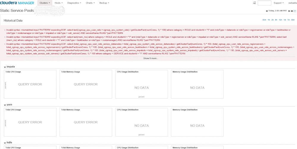

May I know please how to enable this feature if we got this error/issue message?

Hi @Mondi,
Could you please share your Cloudera Manager version? There was a known bug which can cause the error you are seeing. Cloudera Manager 5.15.x and later should have the fix.

Hi @Mondi ,
The source of this issue is the interpretation of the $SERVICENAMEPATTERN variable which is being translated to yarnPATTERN in your case. In the code, there is a bug where a variable $SERVICENAMEPATTERN is clashed with the another variable name $SERVICENAME hence causes the probem.
Yes, Cloudera Manager 6.3.3 does have the bug fix.

@lwanghi Li, our version is 5.8.4, but we are planning to upgrade it to 6.3.3 so i think it will be manage once we have the upgrade, may I know please what specific bug is this? so I can share it with them as well. Thanks!

Hi @Mondi ,

Got it. Thanks @lwang
