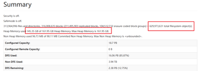

Hi, I have a Hadoop 3.1.1 cluster and recently I found that the NameNode heap memory usage in the cluster is very high. I saw 629973631 file objects in the cluster through WebUi, so according to my calculations, it should occupy no more than 90GB of memory, right? Why is the current memory usage consistently above 140GB? Is this related to me enabling erasure codes?

Hi @Meepoljd ,
The file and block metadata consumes the NameNode heap. Can you share how did your calculation?
Per our docs:
https://docs.cloudera.com/cdp-private-cloud-base/7.1.8/hdfs-overview/topics/hdfs-sizing-namenode-hea...
the file count should kept below 300m files. Also the same page suggests that approximately 150 bytes are needed for each namespace object, I assume you did your calculation based on that. The real NN heap consumption varies with the path lengths, ACL counts, replication factors, snapshots, operational load, etc. As such in our other page
https://docs.cloudera.com/cdp-private-cloud-base/7.1.8/hdfs-overview/topics/hdfs-examples-namenode-h...
we suggest to allocate rather a bigger heap size, 1 GB heap for 1 million blocks, which would be ~320 GB in your case.
Hope this helps,
Best regards, Miklos
