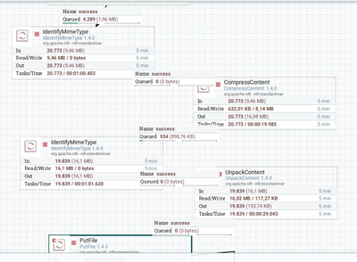

@Salda Murrah I forgot to tell about IdentifyMimeType that can be used to automatically identify the type of your file https://nifi.apache.org/docs/nifi-docs/components/org.apache.nifi/nifi-standard-nar/1.4.0/org.apache...
Created on ‎11-09-2017 08:32 AM - edited ‎08-18-2019 12:24 AM
- Mark as New
- Bookmark
- Subscribe
- Mute
- Subscribe to RSS Feed
- Permalink
I managed to solve it by using those identify.mime.type-processors.
But there is still a setting which leads to fill my hard drive completely.
I guess UnpackContent is always getting new files to extract them, but when getting files in GetFile-processor I need to keep the source files, do you have any idea what I need to change?

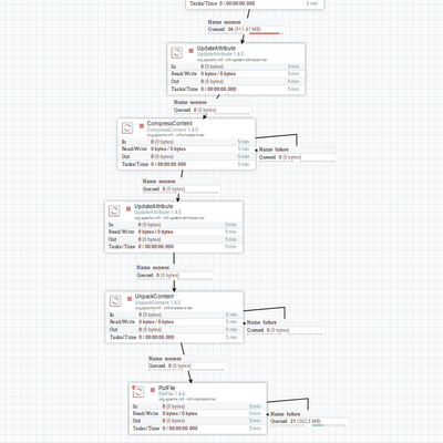

Created on ‎11-08-2017 01:00 PM - edited ‎08-18-2019 12:24 AM
- Mark as New
- Bookmark
- Subscribe
- Mute
- Permalink
Thanks so far.
But do I still need both processors (UnpackContent and CompressContent) for my use case?
I am not sure how it should work out: If I add an attribute mime.type, will the UnpackContent processor get what I want?
I tried to set the mime.type attribute to application/${filename:substringAfterLast('.') and it extracted .zip and .tar succesfully, but I still got those compressed .gz files.
It looks like this:
Created ‎11-08-2017 01:51 PM
- Mark as New
- Bookmark
- Subscribe
- Mute
- Permalink
I am not sure I understand your use case. Why do you use UnpackContent after Compress ? CompressContent can decompress your gz file with the decompress option.
Created ‎11-09-2017 08:34 AM
- Mark as New
- Bookmark
- Subscribe
- Mute
- Permalink
But I didnt manage to extract .tar nor .zip files with CompressContent.
I have many different files (.tar.gz, .tar, .zip ...) which should all be decompressed/extracted at the end.
I thought first of all I get to know all .gz files to decompress them (see first two processors in my screenshot), after that I want to extract all other files (.tar and .zip) what happens in the following two processors.
For example: Getting an 'test.tar.gz', decompressing it to 'test.tar' and extracting it to 'test' afterwards.
