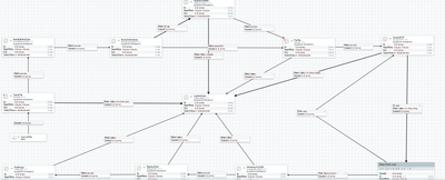

New Member
So at my top level I have my nput port, common fetch process group and multiple list process groups:
I set my input port to support 10 concurrent tasks which I though might help but I’m not really sure.
Each list process group contains the following which includes the remote process group:
I’ve tried both RAW and HTTP, RAW seem to be a little better on recovery be not perfect.
My common fetch process group contains the following:
No real issues here if the remote process group can find the the iinput port everything works as expected.
