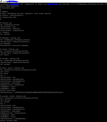

I have already configured ambari ldap setup according to the value I got from ldapsearch. but still i am facing the same issue.
