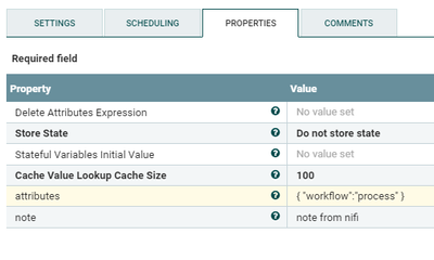

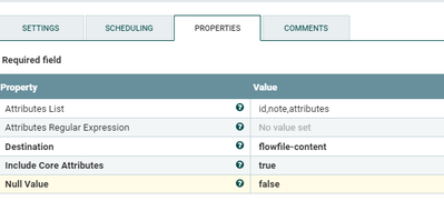

we want to create new attribute with value and this attribute is a dictionary type so we have to pass the data in the dictionary format for this we have used updateattribute processor and attributetojson processor.
updateAttribute processor snap
Attributetojson processor snap
and the below is out of attributetoJson processor (flowfile)
{"note":"note from nifi","attributes":"{\n \"workflow\":\"process\"\n }","id":"1ecfbcbb-38bf-49e9-a77e-a88w"}

as per my knowledge this is type error. I think the Dictionary is not sending in correct format . i have also used ${attributes:unescapeJson()} in updateAttribute ...but i think i have made a mistake in the declaration
property_nameproperty_value
attributes{"workflow": "process"}
'attributes' ${attributes:unescapeJson()}

@renuu You have to build the final values you want as separate key value pairs like this:
UpdateAttributeUpdateAttribute
Next you will use these attributes  to create a json object attribute using AttributesToJson:
AttributesToJson flowfile-attributeAttributesToJson flowfile-attribute
After that, if you inspect the flowfile you will see the json object as JSONAttributes:
FlowFile Attribute JSONAttributesFlowFile Attribute JSONAttributes
From here you can use it as ${JSONAttributes} or if you need it to be called ${attributes} you just use another UpdateAttribute:
