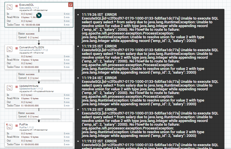

Hi All,
I was able to solve the above problem (the issue was jar file which I was referring was outdated) but now facing another issue attaching the screenshot of that
The issue of the above problem which I able to understand is salary & emp_id has bigint as a data type that why it is throwing do not know how to handle it (because users will give database name and table name dynamically through NiFi I am fetching those details) that if I convert it to int/double it is working fine any help will be great
