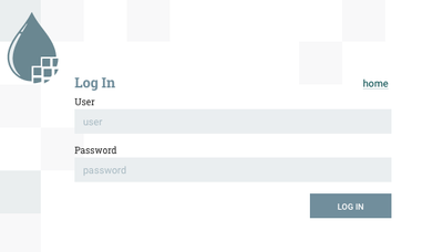

Kerberos Login
There are two ways we can authenticate to NiFi using Kerberos:
Kerberos Login - NiFi presents a login screen and authenticates the user against the KDC.
SPNEGO - A ticket that was established outside of NiFi is forwarded to NiFi through the browser.
If we navigate to NiFi in our browser at https://nifi.apache.org:9445/nifi, assuming we didn't already configure our browser for SPNEGO, then we should get prompted with a login screen:
NOTE: If you have a client certificate in your browser that corresponds to this NiFi instance, you may get prompted to use that certificate, but we want to decline in this case so that we end up at the login page.

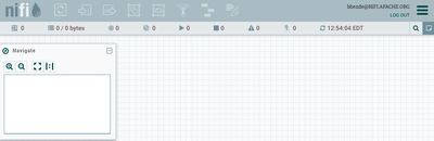

At this login screen we can enter the principal name and password (in this example bbende and bbende) and we should get authenticated and see the NiFi UI:

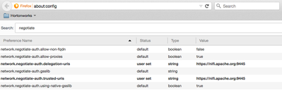

SPNEGO
Using SPNEGO requires some extra configuration in your browser. I am using Firefox which requires going to the about:config page and setting the following properties:
NOTE: The trusted URIs are the host and port being used to access NiFi in the browser, which in this case is https://nifi.apache.org:9445. This works because of the mapping we setup earlier to map nifi.apache.org to localhost.

You should then be able to go to the NiFi UI in your browser without requiring a login.

For me, everything is working, except the "SPNEGO" part:
a) When I open "https://myhost.de:9445/nifi" (without a kinit before), my Kerberos Client asks for authentication (which looks good). When I enter the principal and password, it continues with step b.
b) When I already made a "kinit" before opening my browser and entering "https://myhost.de:9445/nifi", I always get the username / password prompt as shown in section "Kerberos Login".
What am I missing here? I configured the following settings in my Firefox browser:
Tested it on Centos7, Ubuntu and Windows, I always get the login screen, instead of skipping it after the "kinit". Can you help?
Master Guru
No problem, glad it was helpful 🙂
If you are reaching the login screen, then it means your browser is not forwarding your credentials to NiFi.
You could try setting the negotiate properties to just "myhost.de" instead of the full url with port.
Another thing to look at might be the domain being used by your KDC...
In this example I was using nifi.apache.org as the domain, so I had to add a mapping in /etc/hosts to map nifi.apache.org to localhost so I could use nifi.apache.org in my browser to access my local NiFi.
If you are accessing myhost.de to get to your NiFi instance, but that isn't the domain in your KDC, then it won't line up and probably won't forward your credentials.
