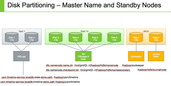

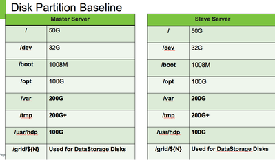

Step 2: Get your Disk partitions Right
See the following for some guidance. Take note of the hadoop properties and default locations. You need to have this done ahead of time.
Disk Partition Baseline
Name Nodes Disk Partitioning

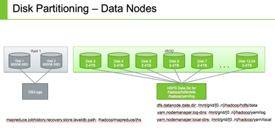

Data Nodes Disk Partition

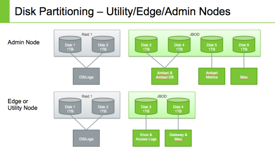

Ambari/ Edge/ Ranger/ Knox Nodes Disk Partition

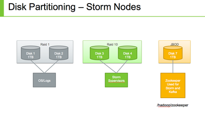

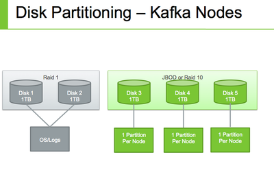

Storm and Kafka Nodes Disk Partition

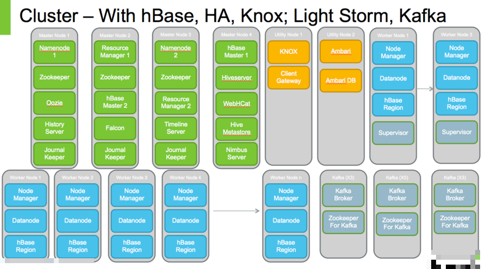

Step 3: Don't Scrimp on Master Nodes. Know the Placement of Your Master Services
If you want to do yourself an injustice, just allocate one or two master nodes.
If you want to do things properly, and you want to be set for up to 50 nodes, then please have at least 3 master nodes, better 4, if you doing HA, with at least 1 Edge and 1 Admin/ Ambari Server.
It is a PAIN and some effort involved to move master services if you don't get it right.
Figure out where you placing your Master Services. Use the following as a Guide:

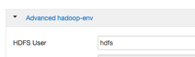

Also set HDFS User to your <cluster-prefix>-hdfs also in Advanced hadoop-env.

@Ancil McBarnett, Could you please explain why you propose /dev as a separate 32G partition?

One question, We have 2* 80 GB 5G SATA SSD RAID-1 Hard-drive for Master node, in this blog-post, it suggests 32 GB for /dev partition.
Please suggest the recommended partition by considering the above hard-drive limits
