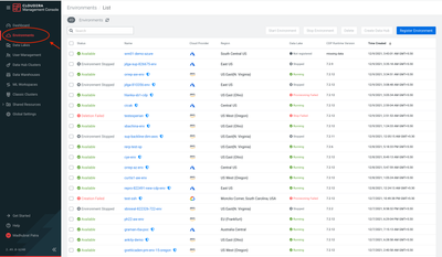

  1. Click Environments from the CDP Management Console in the left panel next to DashboardScreenshot 2021-12-09 at 12.04.20 PM.png 

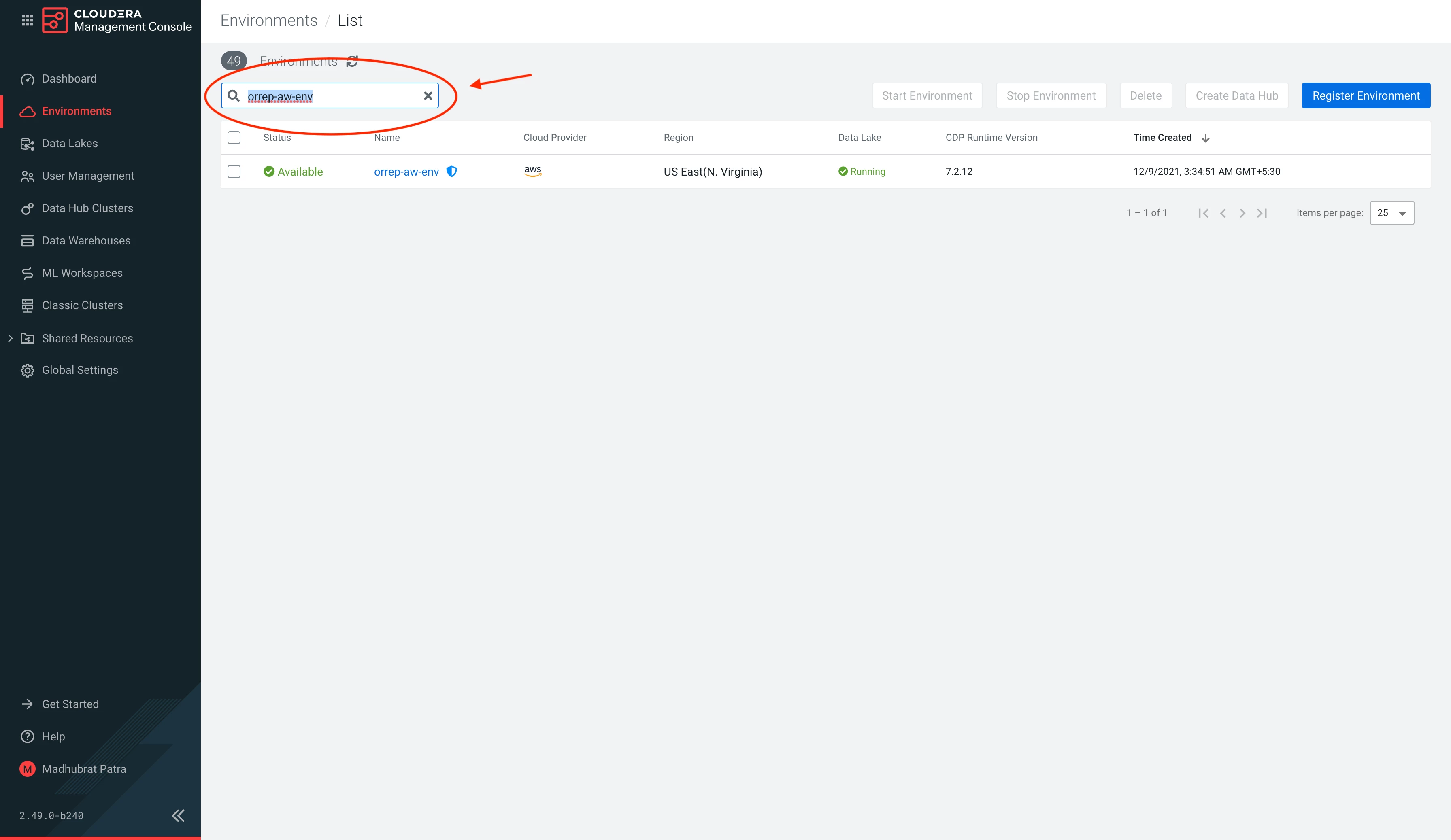

  2. Type in the name of the environment in the search bar. In the screenshot here, the search key is "orrep-aw-env"

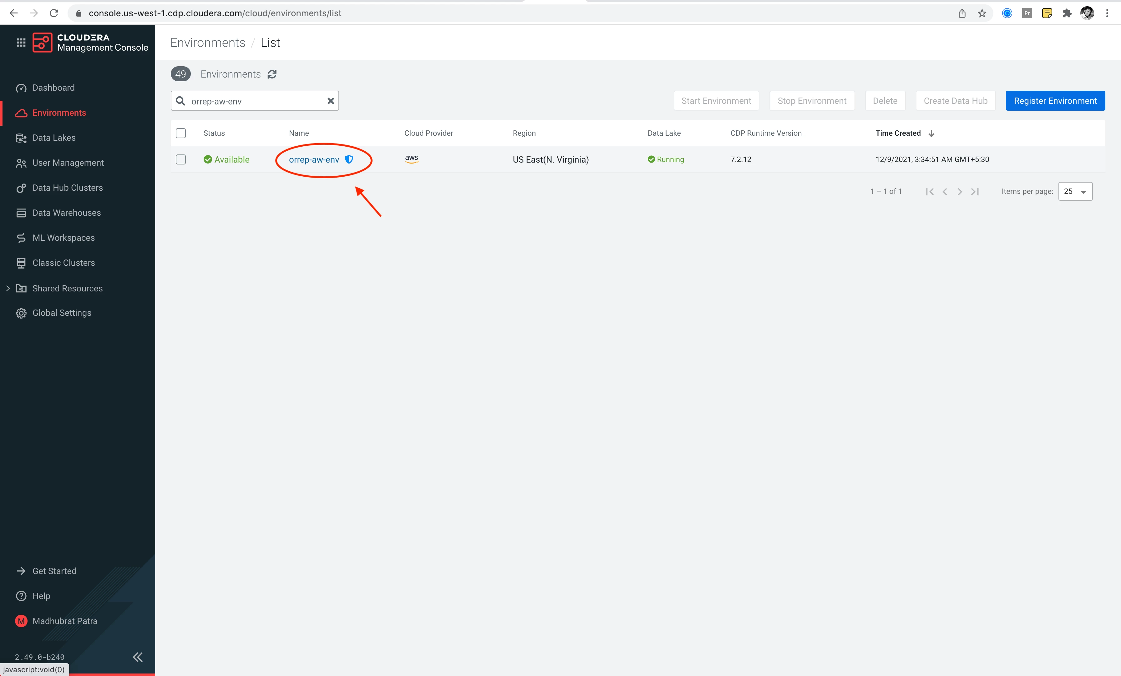

  3. Click on the "Name" of the environment. This should show the details of the environmentScreenshot 2021-12-09 at 12.09.09 PM.png

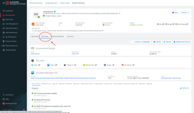

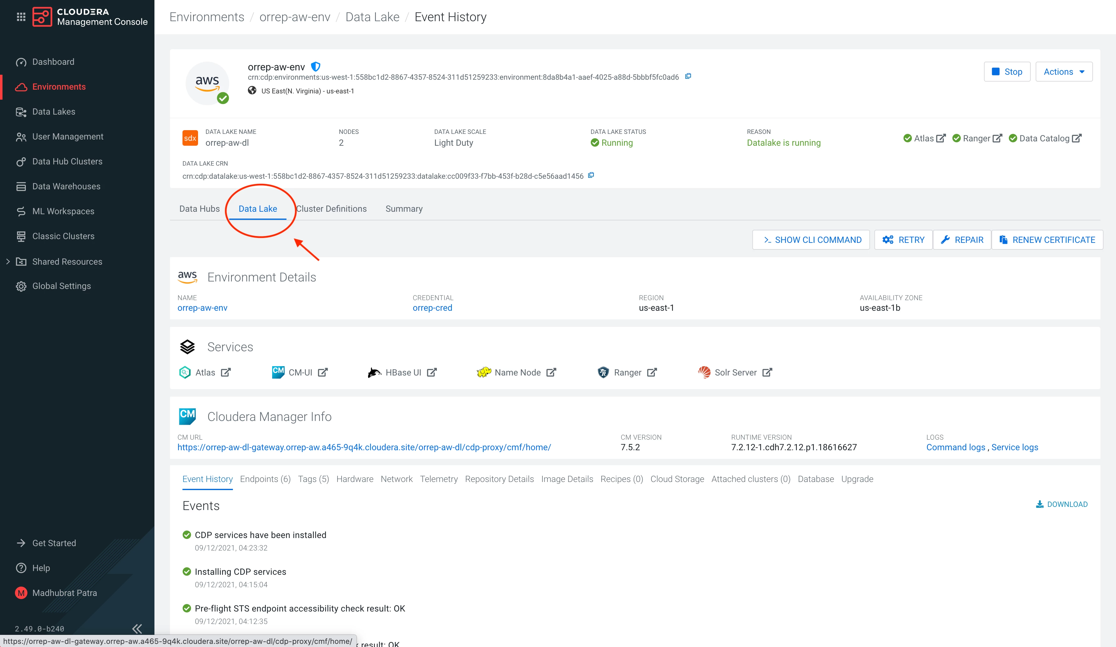

  4. Click Data Lake

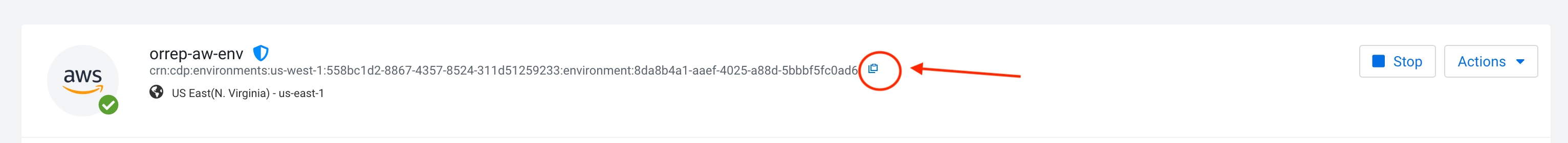

  5. Now, click Copy to Clipboard icon next to "crn: ..." in the headerScreenshot 2021-12-09 at 11.52.58 AM.png
 This should copy the CRN to the clipboard. Now you can paste it as and where needed.
