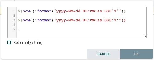

In above you can see your NiFi EL statement as copied and pasted on line 3. You'll notice the color coding indicates an issue with the function's input parameters.
Line 1 has the properly formatted version of that same NiFi EL statement.
Be careful when using copy paste from some external editors.
