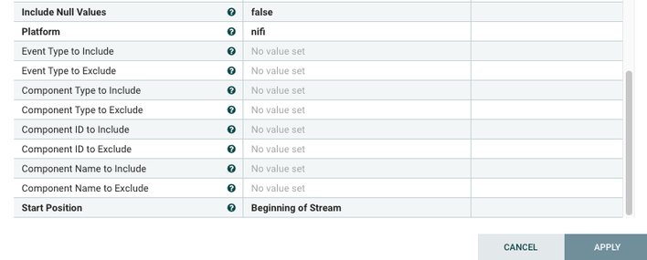

I have tried to configure the Site To Site Provenance Reporting task
Unfortunately, I am not able to get it working as i understand that it is not possible to configure Site to Site with security disabled while also running NiFi with HTTPS. Those settings go together
Please advise on how to get this working. Many Thanks

S2SProvenanceReportingTask configuration:
While all of this worked correctly, sending provenance events via the S2SProvenanceReportingTask back to the same NiFi is not advisable.  It creates an endless loop of provenance events.  For every FlowFile received on the "prov" port another provenance "RECEIVE" event is created which then gets set by the reporting task.  This an infinite loop is created. You would certainly have difficulty related to authentication and authorization sending to another NiFi instance using the out-of-the-box keystore, truststore, and single user providers between two out of the box NiFi deployments.   But for testing purposes this works.

The log also says
No events to send due to 'events' being null or empty.

there are entries on data provenance
