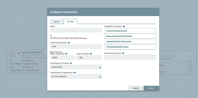

In the latest NiFi, now we can directly connect "GenerateTableFetch" and and "ExecuteSQL" with a connection.
NiFi is evolving 🙂
