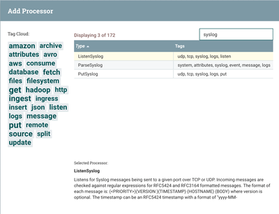

If you drag the add "Processor" icon to your canvas you will be presented with aadd processor UI. In the upper right corner is a filter box. Typing "syslog" or "hdfs" will reduce the list to those processors that share those tags.
Clicking on a processor will display a brief description of the processor in the same UI near the bottom.

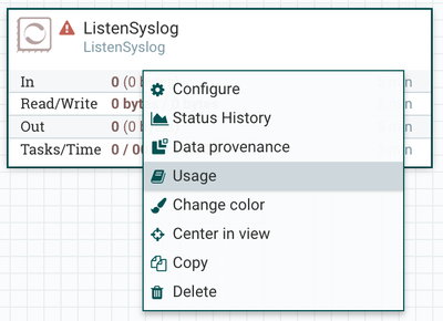

Details documentation can be found in help or by right clicking on a processor already added to the canvas and selecting"usage" form the context menu that appears.
