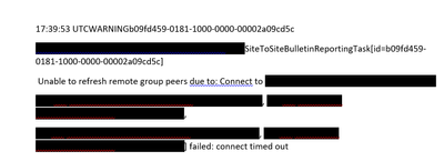

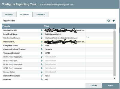

                             I’m trying to Send Bulletin board info to mail using site to site reporting task.
Where I’ve used input port and sending to PutEmail Processor for the FlowFile , upon creating  the Site to site Reporting task and our NiFi is on Kubernetes Cluster.
While establishing this getting ended up with Warning message.  Suspecting are there any policies need to be added to this
Could you please help in establishing this task. I’ve attached all the evidences/configurations with screenshots.
By default its connecting to primary node. As mentioned in the ReportingConfigure mentioned both Destination URL and instance URL as same  value by following the https:// [Full DNS of cluster]:PortNumber. For your info. Cluster is of 3 nodes and our NiFi is of version 1.15.3

So by what you shared, it looks like the background thread that fetches those S2S details is failing due to timeout.  This could be for any number of reasons.  Your configured keystore in the sslContextService does not contain a single PrivateKeyEntry that can be trusted by the truststore configured in the nifi.properties file on all 3 of your destination nodes.  The PrivateKeyEntry presented by the 3 NiFi nodes to the controller service is not trusted by what exists in the truststore configured in your SSLConTextService.  keystore used in sslContextService does not have a clientAuth PrivtaeKeyEntry in it. nifi.remote.input.secure is not set to true. nifi.remote.input.http.enabled not set to true.

Thank you so much @MattWho  For taking time and looking into the issue. Whatever the improvements that you suggested which were already there for site to site details in all 3 nodes.
# Site to Site properties
nifi.remote.input.host=#################
nifi.remote.input.secure=true
nifi.remote.input.socket.port=10000
nifi.remote.input.http.enabled=true
nifi.remote.input.http.transaction.ttl=30
secnifi.remote.contents.cache.expiration=30 secs
and both ServerAuth and ClientAuth privatekey Entitiy allowed in all 3 nodes.
as you are telling Authorization Exceptions. I've experienced those errors too earlier before when tried to call one node from other node (Unable to refresh remote group peers due to: response code 401:Unauthorized with explanation: null),
Please let me know if this error is specific to certificate which i'm referring to using SSL/is this due to the Destination URL which i'm using / are there any specific properties which i need to look in?

Expert Contributor
Thanks for the Suggestions @MattWho . Was able to sort of the authentication issue and i also  tailed the nifi-user.log , in that observed authentication successful. But now I'm observing a different error. the input port name  which I've given in Configure Reporting Task settings even though my flow is root of the canvas.
Could you please help on this issue.
Expert Contributor
Hi @MattWho , After i Enabled Retrieve site-to-site details for the Input port BulleInfo, then i was able to receive the BulletinInfo.
Thank you so much for you suggestions!!
