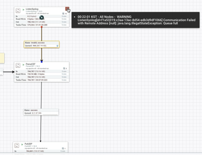

hello. I'm having a problem with Nifi, so I'm posting a question.
In my Nifi, an error occurs in one node, and there is a problem that the node is disconnected in the cluster
A total of 6 nodes were configured as a cluster with 3 nodes in different datacenters.
The current configuration is collecting network logs through ListenSyslog, ParseCEF, and then sending them to graylog.
It receives an average of 721MB per 5 minutes, but there is a problem that the cluster becomes Disconnected with a Queue Full error occurring on some nodes.
The error message is below.
Communication Failed with Remote Address[null]: java.lang.illegalStateException: Queue full
It says Queue full, but I don't know what kind of queue the error message points to and how to solve it.
