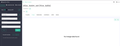

I run the script/tool(import-hive.sh) and i can search the hive entities like tables, database, views, columns,but no lineage, is that nomal?
before install atlas, there are two hive table named atlas_testm and atlas_testm_ext(is a view based on atlas_testm) in my hive database cluster.
after install atlas and run the atlas services , i run the script named import-hive.sh,i can saw these two hive table in atlas ui web by search,but no lineage which is relationship of atlas_testm and atlas_testm_ext,is that nomal?
i want to know whether the script named import-hive.sh does not support hive table's history lineage import?
this problem has been bothering me for a long time.
