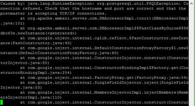

- Ambari Server failed to start. Look at the screen shot
- "Connection refused"
- I can see ambari-server process though
- running netstat -nltu | grep 8080 returns nothing.

Seems you have a DB connectivity problem ,can you copy and paste a complete output of the Ambari failed to start log ?
The connection was closed when Java tried to read from it. This can be caused by:
- The PostgreSQL server being restarted
- The PostgreSQL backend you were connected to being terminated
- The PostgreSQL backend you were connected to crashing
- Dodgy network connection
- Badly behaved stateful firewalls
- Idle connections timing out of the NAT connection tables of NAT firewall/routers
... and probably more. Check the PostgreSQL server logs to see if there's anything informative there; also consider doing some network tracing with a tool like Wireshark.

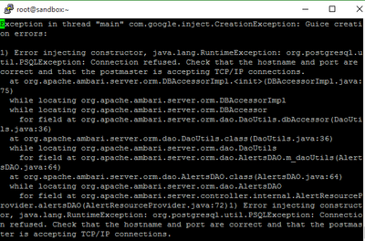

Thanks for your prompt response!
I think the cause for the failure is that the PostgreSQL failed to connect.
service postgresql start
results in : Starting postgresql service: [FAILED]
you can look at the below screen shot too.
vi /var/log/ambari-server/ambari-server.out
Any further fix?

I suggest to remove the vm and reimport the image as there are multiple issues. Postgres down and configuration all incorrect.
