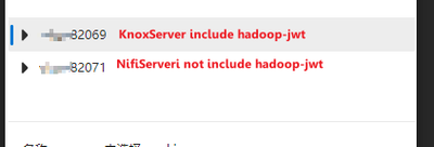

Thanks.I open the https for nifi.And it works when Knox and Nifi on same server.But when I deploy NIFI and KNOX separately, I am redirected infinitely when SSO logs in to NIFI and I find Cookies have problems. Is this because of cross-domain? Knox gateway.log has "JWT cookie successfully added." but nifi-user.log have " [<anonymous>] GET https://XXX:9443/nifi-api/flow/current-user"

I know.Need FQDN likes testhost.magg.com,Thanks
